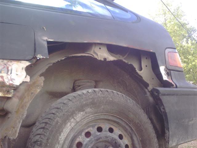

what up people im back and got a 2nd gen ...well sorta
drivers side
new rockers are being installled right now along with 1/4 patches updates to come

hi girly how you been ? not to bad actually just a bit of rust repair lol i traded my 98 si for it lol
the gen 1 got beat up by a cow and i said fack it
he used the cardboard as a backing and layered on the bondo lol
me wondering why he did such a thing
me once again wondering why
little bit of wheelwell work left and 2 holes and t6hen its clean up time bit of filler blocking blah blah blah and the drivers side is done sorta lol

yup lol and i drove 3 hors to the city to get cutting discs haha

because im PBK buddy :-)b :mrgreen: the rust was on the 1/4s and thats it from what i can see.so why wouldnt i ? rust doesnt scare me and never will regaurdless of the amount i'd take it on haha
um forgot to mention this car is a 90 dx or base model and an auto ,allso has a zc with fried rings leaking valve seals and valve cover gasket haha ,so i guess i'm going to have to do a manual conversion and B series swap one of these weekends ,i want to do a boosted D on my hatch so might just use my A1 on this car i dunno
wont be many updates as i work 6 days a week and nights but ill do what i can when i can :-)b

i made a template and will be trasfrering it to steel cutting it out and than making the inner curved part or the door jamb,i dont need to really but the metal has to be pretty soft there since the rust is so close
