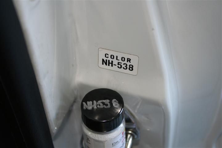

Confirmed that they sent me the correct color

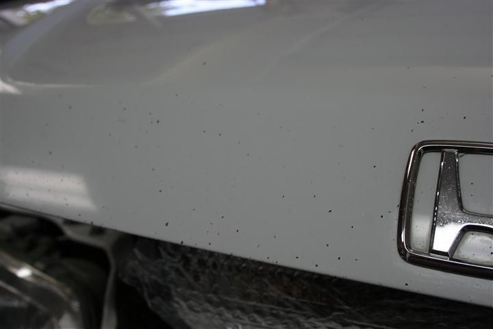

This is what I was dealing with

If you look at the glare on the bottom edge of the hood (second to last pic), you can see that the surface is still pitted. The paint fills it in somewhat and the color disguises it. I didn't clean the brush so I ordered some more. I also got the paint squeegee that they sell.
