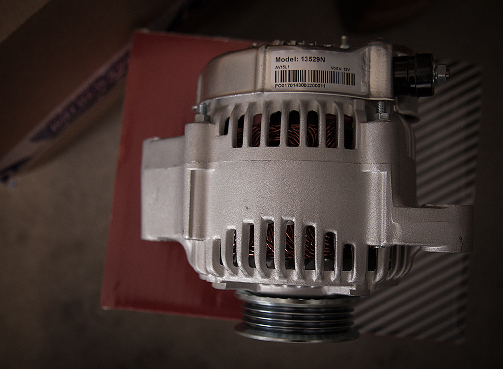

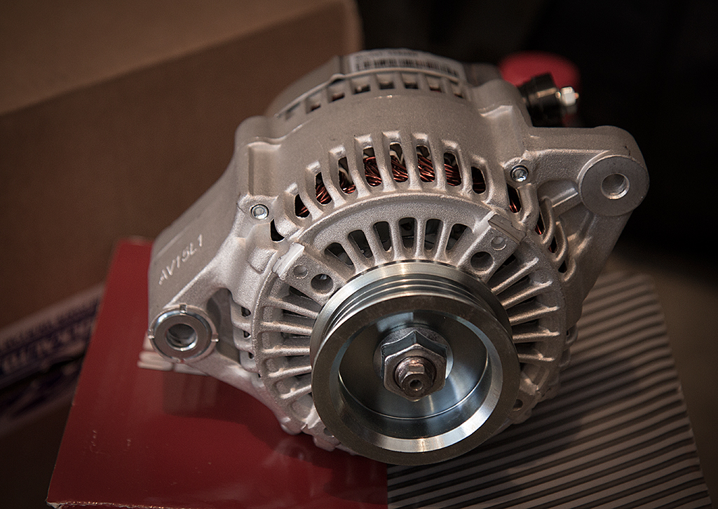

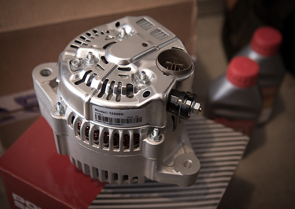

I'd been having an issue for a while now where my battery light would blip when I hit high rpms (7.5k+)
After a bit of research, it sounded like my alternator was probably on its way out. So I picked up a new one from RockAuto (my first time ordering from them actually. It went smooth enough. Was weird though, not buying oem! lol)
Here are a couple photos of the alternator:

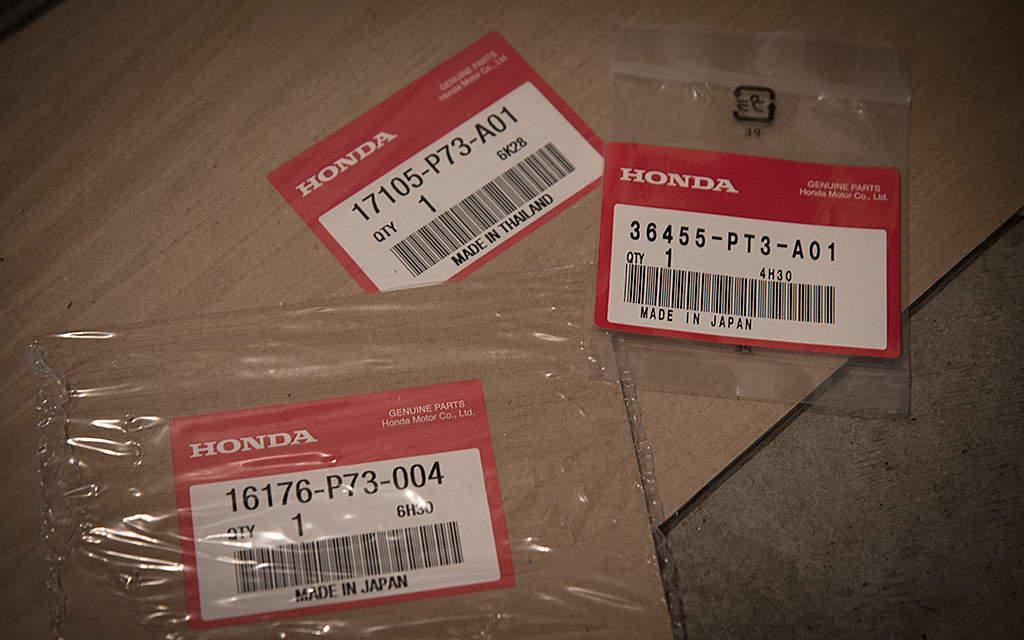

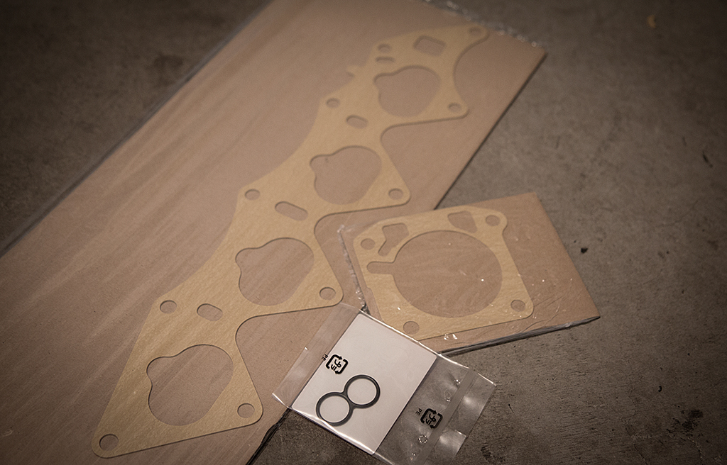

I didn't feel like jacking up the car, removing the driver side wheel, disconnecting the lca, and removing the driver-side axle just to get the alternator out. So I decided to go out from the top. I was still running the original intake manifold gasket that came on my jdm ITR engine years ago, so I figured I can kill two birds. So i pulled off the intake manifold, which game me tons of room to pull the alternator out from the top.
I cleaned up the mating surfaces on the intake manifold and cylinder head, prepping them for a new oem gasket. While I was at it, I picked up new oem gaskets for the throttle body and IACV.

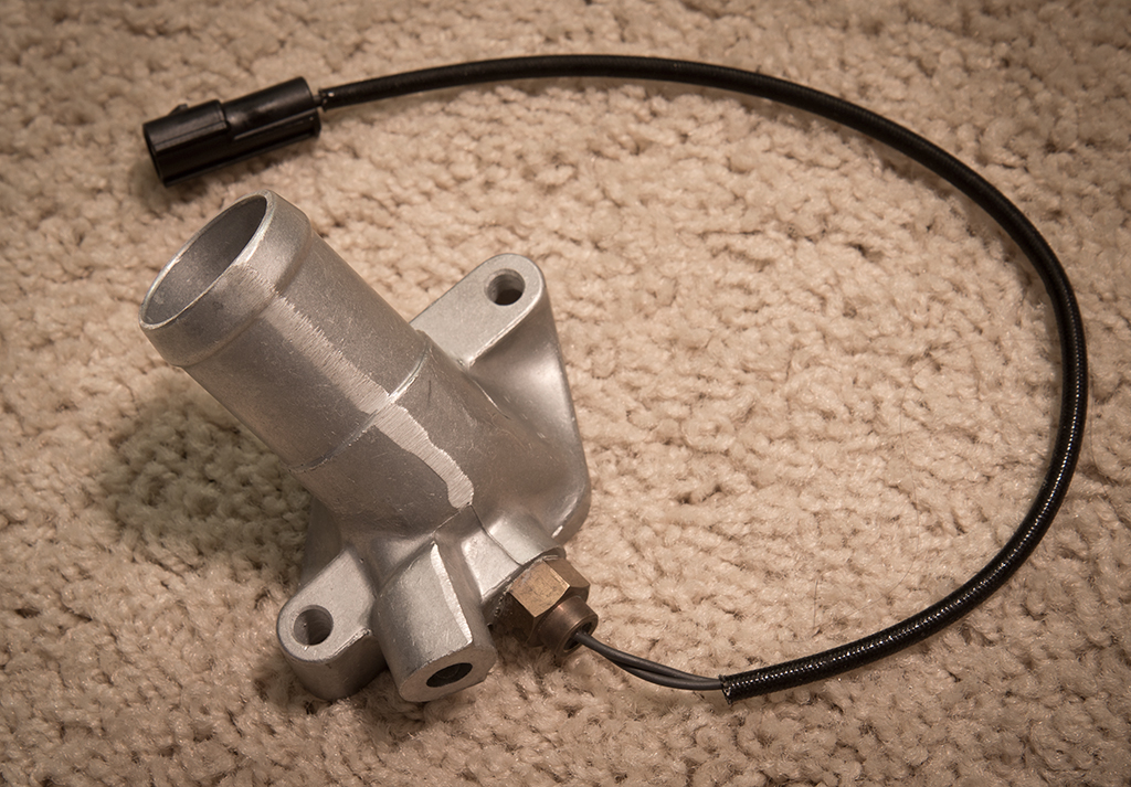

Since I had to drain the coolant in order to pull the intake manifold, I figured that would also be a good time to finally finish a project I started years ago. When I had previously installed my Defi gauges with my old D16a6, I had rigged up a collection of hoses and connectors to attach the water temp. sensor to the back of the block. I was never really happy with that particular setup, and I knew that I wanted to go a different route when I eventually connected the sensor to the B18c5. So I had purchased a new oem water neck, and had my brother tap it for the sensor. That part has been sitting in my garage for years, and now I finally bolted it up to the block.
Here are a couple photos of it:

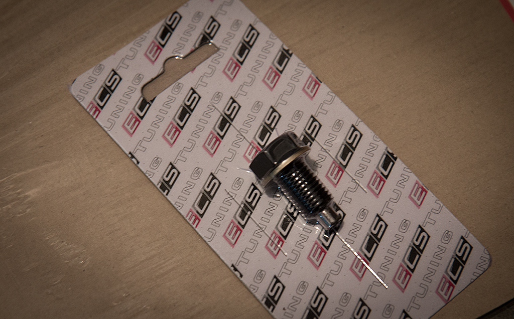

Now that everything was put back together, it was time to put the radiator drain plug back in, and fill it back up. Well, the [crummy] Mishimoto radiator drain plug snapped in half (with very little torque applied to it.) It turns out that Mishimoto used a really funky size for their radiator drain plug, and it wasn't as easy as just heading to a local hardware store to get something to stick in there. From some research though, it turns out that it's the same size as BMW oil drain plugs. So I was able to source one of those fairly easily. I picked one up from ECS Tuning:
I know none of that is particularly exciting, but my CRX is running good again (I can rev it passed 7.5k for the first time in 8 months!), and I can monitor my water temp. and oil pressure with my Defi gauges again. So it's exciting for me. lol

Looking good as always. The coolant temp sensor looks professional! I've always had great luck with RockAuto, and you can usually Google search a 5% off coupon for them too.
