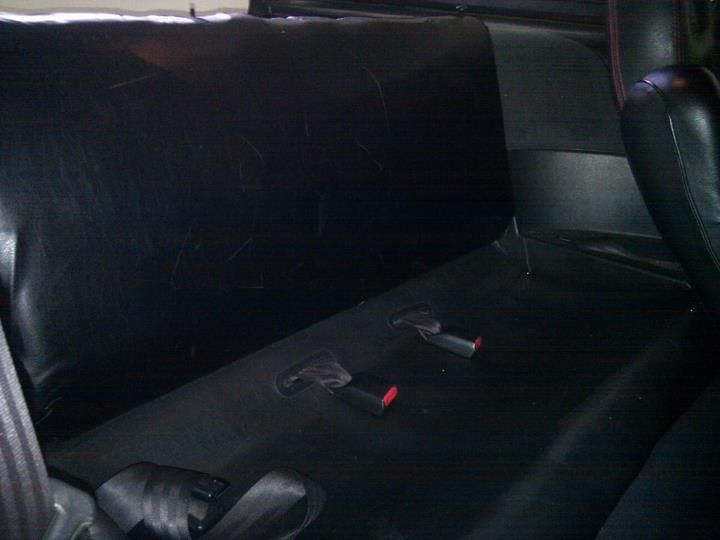

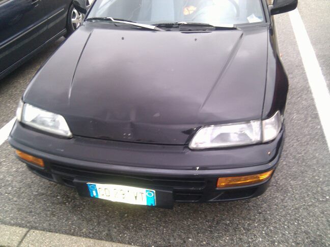

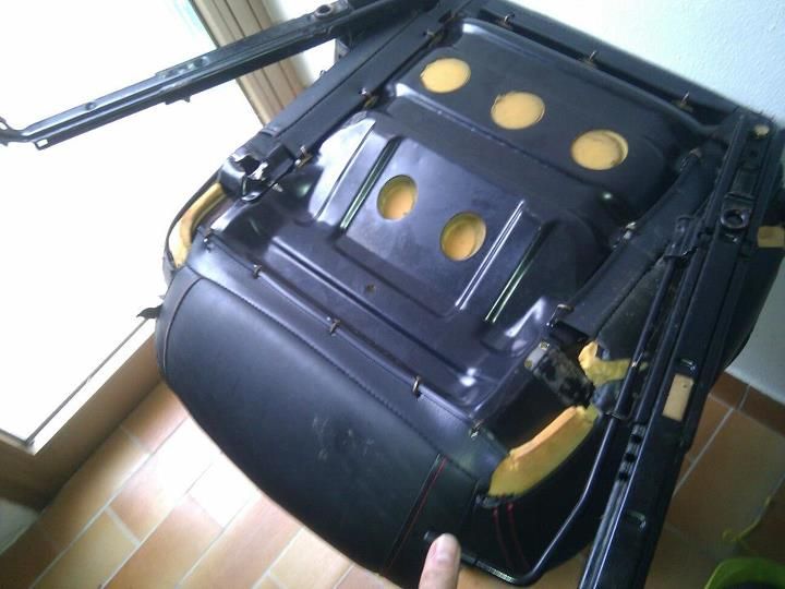

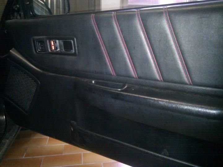

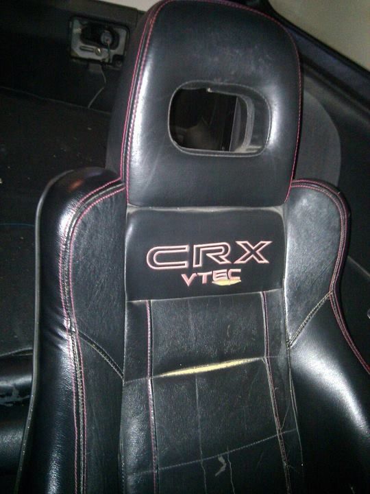

I just picked up my new projekt car, Black Betty, about a week ago. She's a 1991 EDM EE8 B16a1. I've been stationed in northern Italy now for right at a year and have been looking for a CRX the entire time, even as far away as England. After all that time and a bunch of no-go's, a guy on base bought a skyline and tells me his CRX is just sitting there collecting dust. Best part, he has no idea what he has or what he's doing. He sells it to me for $900 and throws in 2 12's in a box with an 1800w amp! After I sell those, the car will have cost me like $750 8)
Good stuff: IT'S A CRX!! It's EDM and has a B16a1, came with headers, CAI and a cat back installed, no rust, no leaks!!
Bad stuff: She had damage to the front and rear, seats destroyed (seat pic is ONLY decent part of either seat), dash cracked, needed 2 new tires, bad CV joint, a short in one headlight.
Not bad at all.., especially since the only thing I wanted her for was the chassis and engine as a projekt platform. As of right now, I won't be able to bring her back stateside when I leave, so I plan on buying parts and building her, then stripping her down and back to original parts when I leave. That way I can re-sell her and take all my CRX parts/engine for a rolling chassis that's in great shape :)
Here's some pics at purchase and the first weekend. I took a sledge and a crowbar to the front and rear and got most of it straight. Can't do anymore until I have a straight rear bumper cover and time to pull the headlights, fenders and front bumper off again:

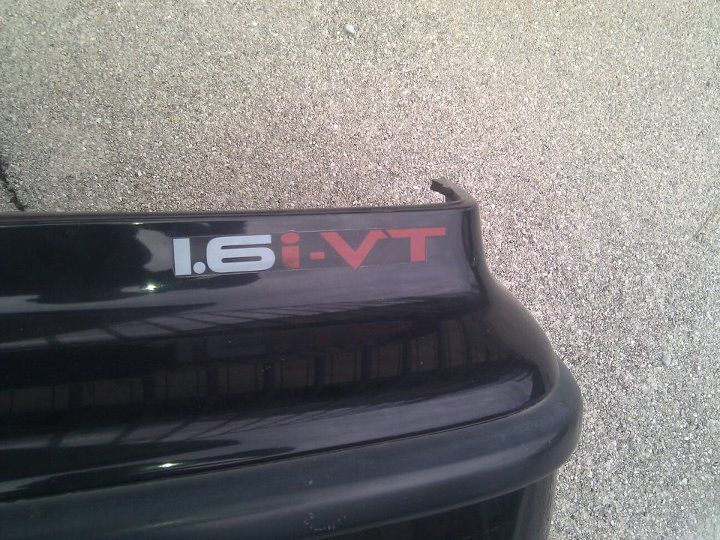

Postby Treezy » Fri Sep 07, 2012 2:20 pm
lol.. that's exactly where her name comes from. I'm kinda nostalgic like that about Alabama. Yeah, I've got an entire build sheet in works. I'm prepping for 400hp and we'll see how it turns out. First things though are a tune-up, oil change, new seats and new cv's. I just put on 2 new front tires to drive on, but she's parked in the garage and I drive my Polo daily. Already got one race lined up with a Mk IV Golf 1.8T and working on a second with a completely stock '05 civic si. That will give me a decent baseline as to where she stands as-is and I can build from there. Also planning to take some trips to the track, but it's like 3.5 hours from here so maybe next spring.
Oh, and new tails are already enroute, stock reds with CRX VTEC on them.

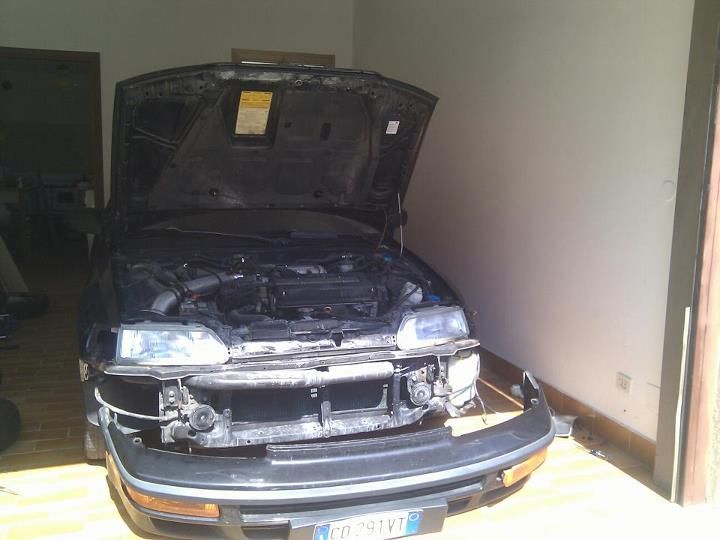

Postby Treezy » Wed Jan 02, 2013 8:20 am
Alright, been a couple months since my last update.., been pretty busy. Here's where I'm at with the car:
Front Bumper Off
Headlights Out
Header Out
Radiator Out
Throttle Body Out
Intake Manifold Out
Oil Pan Out
Intake Out
Battery Out
Engine Cleaned Up (a little)
Seats Out
Here's what I'm putting in the car this month:

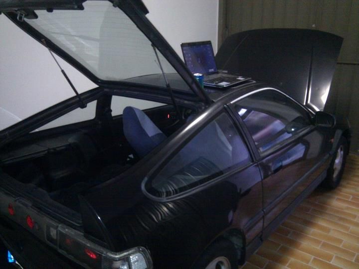

Postby Treezy » Wed Jan 02, 2013 10:04 am
Here's the turbo when I first hung it to check clearance and mounting options
Probably the filthiest engine I've ever worked on.. Had to use a flat head screwdriver to scrap the sludge off, then degreaser, rinsed and scrubbed with boiling hot water and it still looks like [crud]. This is the before pic, haven't taken an after shot yet..
[potty mouth] a blueprint, I fingerprinted that [crud] :P
More pics to come as she progresses..

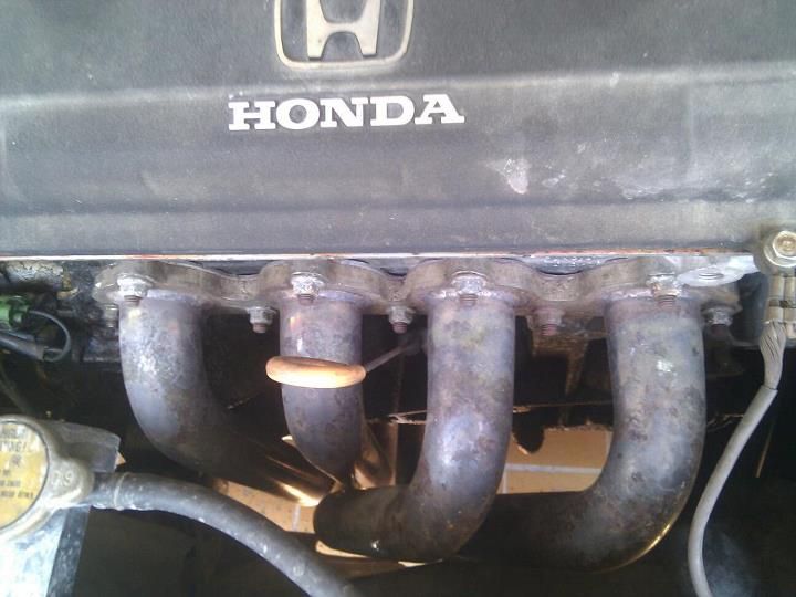

Postby Treezy » Thu Jan 03, 2013 2:53 am
Here's the header that I had to take out..
New BLOX IM
New OmniPower 68mm
New AEM Rail
Founder, Evasive Illusions MSC

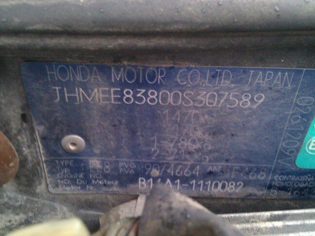

Yeah, she's actually a 91. I had to go to Honda with the VIN to get the right info. The shop told me she was a 90 so that's what I went with. Couldn't find a VIN decoder that unlocked those two zeros so I just asked them. But it's still better than what my registration & insurance paperwork says: 1992 :rolleyes1: lol
